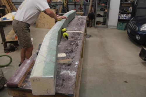

Wing CS Spar outer layups
Trimmed layup, cleaned up some blobs.

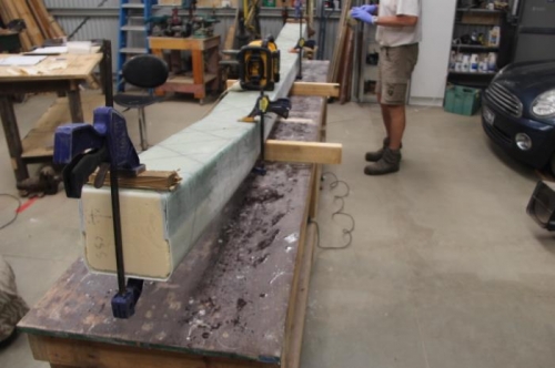

Cut flox corners on ends that won't flow over from AFT face with Dremel.
Prepped sites for LWA2/3 and floxed in place secured with trigger clamps, adding a block over LWA3.
Pre-filled edges with excess flox.
After a few hours break the flox was setting up nicely so finished floxing the edges of LWA2/3 and layed up 3 x UND strips over each hardpoint.
Floxed up the ends, prepped foam and 1 x BID over the aft face of the hardpoints, overlapping onto the ends
Cutting out inspection holes
Trimming transition
Outer hardpoints in place
