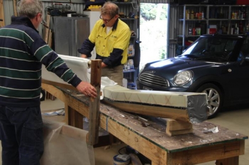

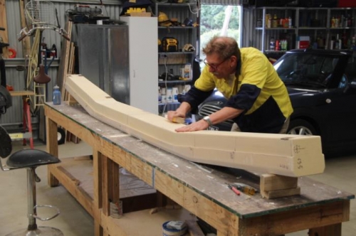

Trimmed some flox blobs, radiused the AFT edge and prep sanded the foam.

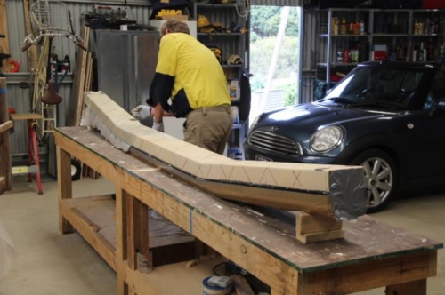

Taped up the rest & applied micro slurry, then 4 x UNI over the shear web @ 45 degrees and peel ply.
Radiusing the edge
On with the UNI
More UNI
