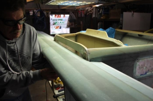

Brief Description:  Fixing Canard rear attach pins
Relieved Fuselage side cutout for Elevator torque tube to permit Canard to slide aft 0.5" onto pins.
Packed out the STBD pin with a short length of 3/16" threaded rod. Thought afterward could have used a piece of plastic and saved a gram or two. Floxed in pins and covered with the plans polythene film, which worked better than the box tape. WTG Nat.
Used leftover flox to create new flox corners in newly exposed side foam, and covered with more polythene film. Have no leftover epoxy, so will put on a 1 x BID patch later.
Pins floxed in and covered, revising flox corners in Fus sides
Bolting on the Canard. Bugger me, it worked!
