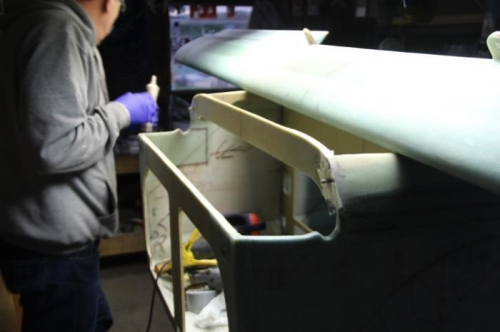

In a bit of a rush, but figured I had time to flox in the pins.

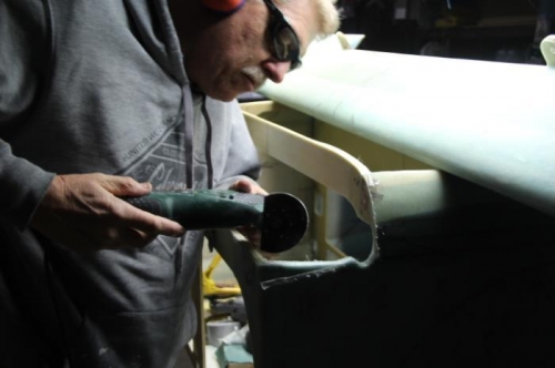

Trimmed layup.
Drilled rear pin holes out to 1/4" and floxed them in.
Attempted to fit Canard, and discover the way I had relieved the sides for the Elevator torque tubes meant I could not slide the canard onto the pins. Also note the STBD side pin goes too far into its hole, because I had made it too deep. If I hadn't been in a hurry I would have made a trial fitting first. Stupid, stupid.

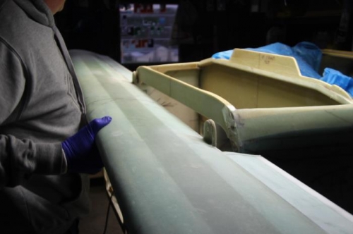

Pins floxed in and covered with box tape
Doesn't smegging fit!
