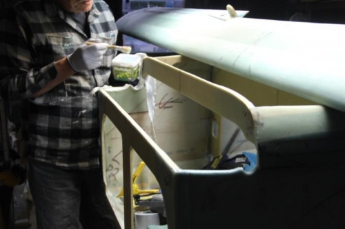

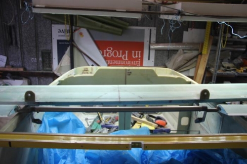

Assembled Elevators and spool piece onto Canard and trial fitted to Fuselage. Make the discovery that the Elevators can only be fitted or removed with the Canard out of the fuselage. Wasn't expecting that.
Roughly trimmed Elevator inboard ends clear of the Fuselage and enlarged the side cutout.
Set Elevators to zero degrees and marked the profile on the fuselage for subsequent fairing, as per VH-WEZ.
Removed Canard and made small flox corners in Fuselage side foam, then layed up 1 x BID over the exposed side foam and up over F-28/Longeron ends.
