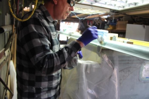

Step 2
Attaching Canard rear tabs
Looked in the workshop at 6AM on the way to work, Shed was at 12.9C, It was 15C under the heat tent and the heater was going. Seems to work well!
Later removed Canard and trimmed first layup.
Re-drilled tab pilot hole.
Profiled rear of tab and sanded back bottom of Canard. Taped up the NC-4 adjacent to the tabs.
4 x BID over rear of tab and 1.5" onto Canard.
Trimming the tabs
4 x BID
