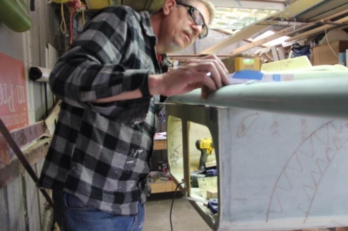

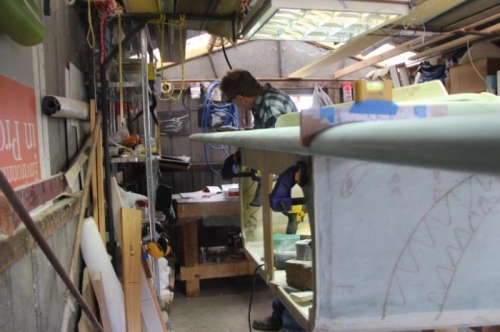

Brief Description:  Aligning the Canard
Set the incidence, level and alignment. Mark the sides and F-22. Remove the Canard, trim and sand. Put the Canard back on, and repeat.
Finally happy with the Al shims in place.
Marked front tab location and removed canard.
Layed up a pad of 5 x BID, tapering to 1 at the top. Wet out the glass on peel ply on the bench and stuck them on. Lekky scissors are not working well, I think I've buggered them by forgetting to clean them.
Taped the tabs and clamped on the Canard, checking incidence, level and alignment.
Getting the incidence right
