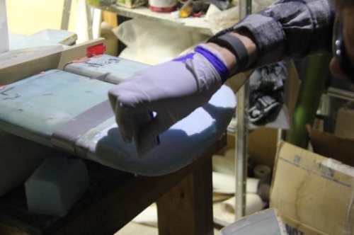

Prepared cured micro on bottom of Canard tips.
Micro'd tips and inserted flox.

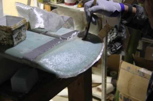

Layup up Canard tip bottoms, 2 x UNI @ 30 degrees.

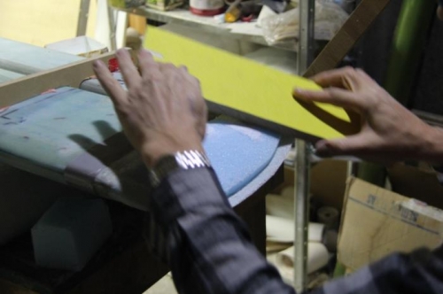

Smoothing cured micro
