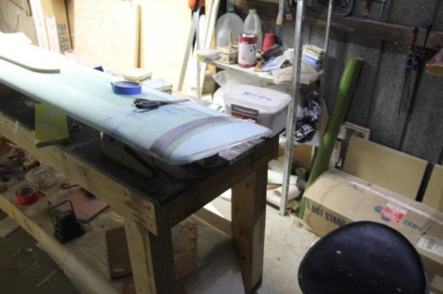

Step 5
Canard tips
2 x UNI at 30 degrees over Canard tips.
Leftover dry micro into Elevator overlap.

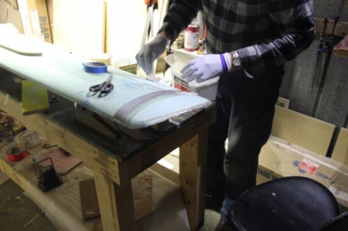

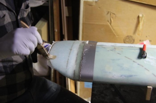

Stipple, stipple
Stippling done
Filling Elevator TE overlap
