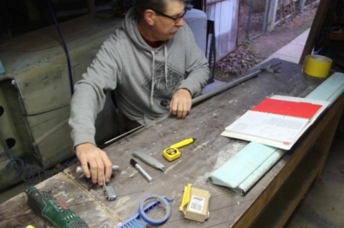

Step 4
Assembling Elevator Hardware
Trimmed Elevator end Layups, still delaminated a bit at the trailing edge.
Trimmed spool piece to achieve 31.2" between hinge points.
Drilled, reamed and bolted up spool piece to offsets.
Trimming the Elevator ends
Cutting the spool piece
