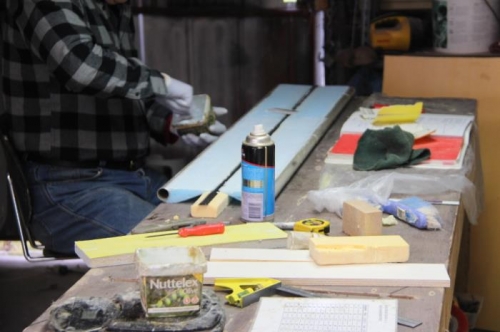

Layed up Elevator bottom skin 2 x UNI, using two pieces 11.5 x 57" rather than four pieces 7 x 57" as per plans.
Realised on completion I had forgotten the intended joggle for the CS-10 attach tapes. Will do on top skin.
Not sure why I left a can of contact cleaner in the way for the whole day.

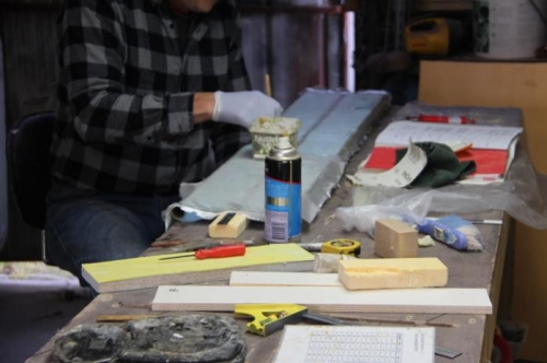

Micro, micro
Second ply

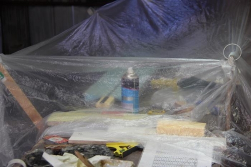

Under the tent.
