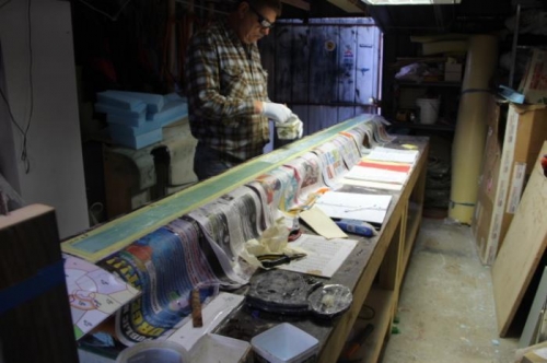

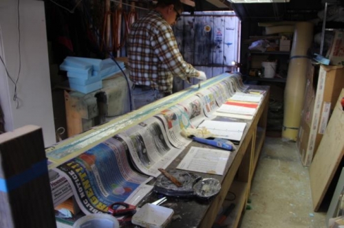

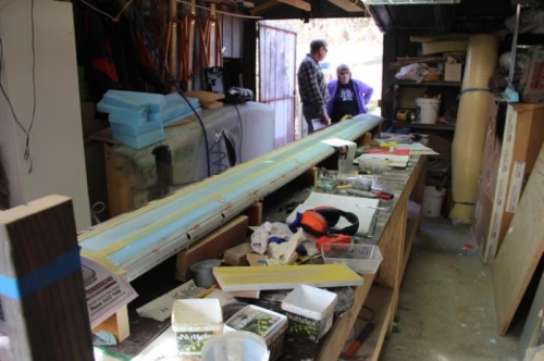

Canard upper spar cap layup
Sanded Elevator hinge hardpoints smooth.
Masked off Canard foam.
Layed up Canard upper spar cap. It took 13 plies, using 93.4' of spar tape. Peel ply over the top.
Negotiating lunch time while masking off the canard.
Stipple, stipple
Last ply!
