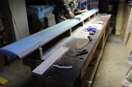

Brief Description:  Preparing for Canard upper spar cap
Inverted Canard and cleaned up table.

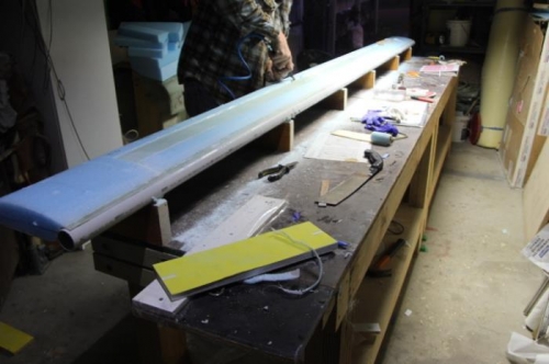

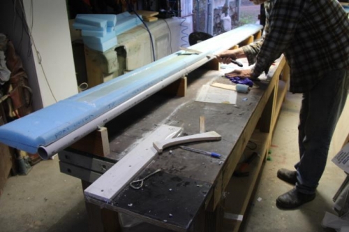

Cut off fish tail with pull saw. Profiled with sanding board and checked with F template.
Roughly trimmed excess drippy micro from joining the LE cores with die grinder.
Sanded off some micro spots from the TE overlap, looks like I got some on the peel ply. Smoothed the transition from the foam to the glass to yield a 0.5" overlap, because 0.3" just looked too small. Will need a minor fill, as per the Wing TE.
Cutting off the fish tail
Sanding to profile
Sanding to profile
Cleaning up the micro
