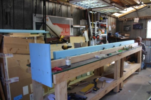

Played with string and wedges for a bit more, then micro'd Inner Cores to the Center, then bondo'd Inner Cores to jig.
Marked up Canard Nutplate cutout on Centre Core & notice they are 3" wide, not the 2" I had allowed for in the dowell placement after misreading the plans. Poo, will go through the edge of the BID pad, will at least miss the Tab. Then noticed I was affecting the alignment of the cores, and squeezing more micro out of the joints. Stopped work to fix.
On checking I notice the Central Core was aligned with the Inner ones at the leading edge, but had twisted up at the TE. Spent more time with string and wedges and left it to cure.
Cleaning up excess micro in Core joins

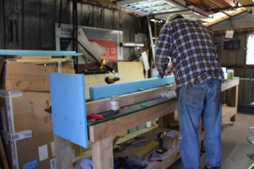

Egad! It has moved!
Egad! It has moved!
