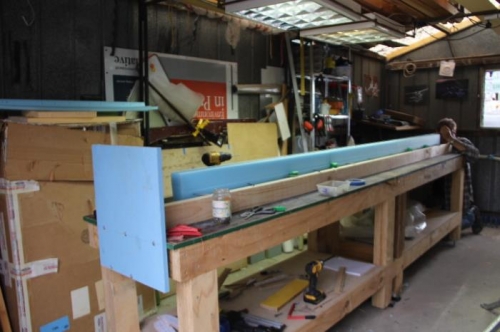

Brief Description:  Preparing for Shear Web
Placed a old cupboard door on the end of the jig, and ran string lines from nails inserted into it. Played with string, levels, wedges and sighted edges until my eyes watered. Which mainly proved the STBD inner Core has a bow in it and that I hadn't marked the centreline very well.
Eventually found something I was happy with and bondo'd Center Core to jig.
Hmmmm. Straighter than my centerline...
Bondo'ing nails to jig fro Center section
