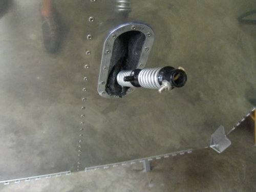

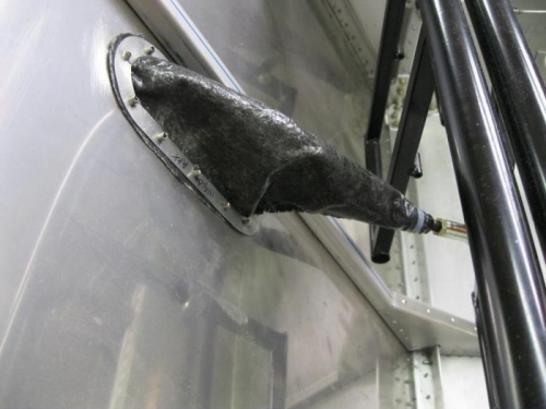

Brief Description:  Re-make the steering rod boot.
My double split collars did not come in so I am re-making the steering rod boot. The original boot I made was too stiff and resulted in stiff rudder pedals. The boot needs to be flexible to collapse and expand with the rudder pedals. So drilled out some rivets and installed the newly minted boot.

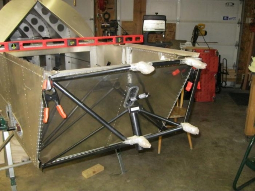

I also took some time to study the plans and even clamped the engine mount to the fuselage.
Steering rod boot.
Steering rod boot.
Rod and boot from firewall side.
Engine mount clamped to the fuselage.
