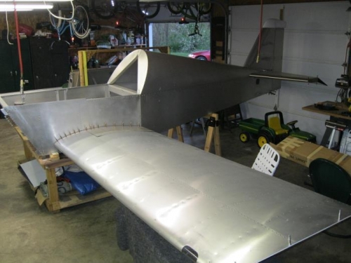

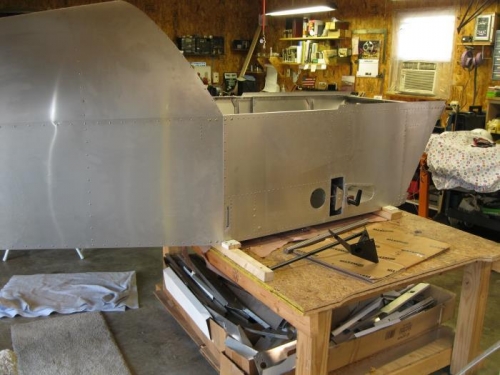

Today I riveted the rear spar attach angles, the aft main spar attach angles and gussets. I also riveted the spar tunnel except the 3 pounded rivets on each end of the tunnel. I installed the left wing and clecoed the wing doubler along the second row of rivets in order to measure the amount to be trimmed. I also riveted the mounting brackets for the controls. I am amazed that the parts I made 3 and 4 years ago fit perfect in the forward fuselage.
No more clecoes on the fuselage. Finally.
Notice the lack of clecoes on my fuselage.
