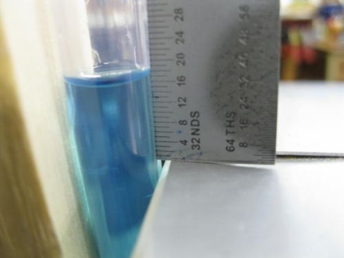

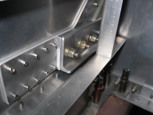

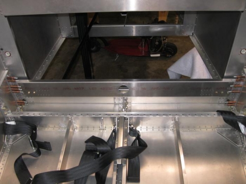

Today after re-verifing the correct wing position,Using the water level the left wing sits 1/32nd inch lower and both inboard aft wings measure perfectly at the required 3 and 5/32nd inches. Having attained almost perfect wing position, I riveted the rear spar carrythrough assembly to the spar attachment angle fittings. The attach fittings will be riveted from the outside fuselage skin after the wings are removed.
Re-verified wing position with a water level.
Rear spar carrythrough installed.
rear spar carrythrough done.
