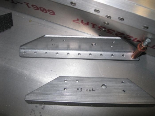

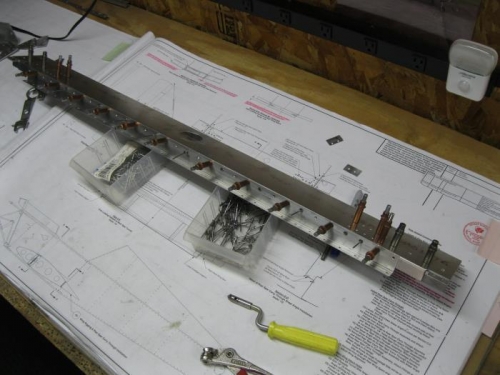

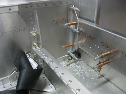

Today I finished most of the rear spar carrythrough. After verifying the wing position was correct I positioned the rear spar left and right hand attach angles, pilot drilled and clecoed to the spar and fuselage side skin. I also positioned, pilot drilled and clecoed the shear angle to the spar and rear fuselage.
After updrilling and deburring I riveted the shear angle to the spar and the rear fuselage. Lots of drilling and deburring today.
Rear spar attach angles.
Rear carrythrough and attach angle
ready to rivet shear angle to spar carrythrough
