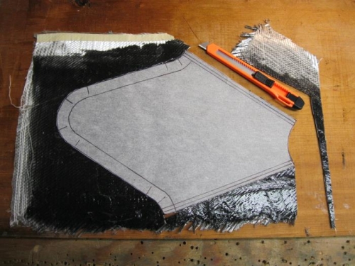

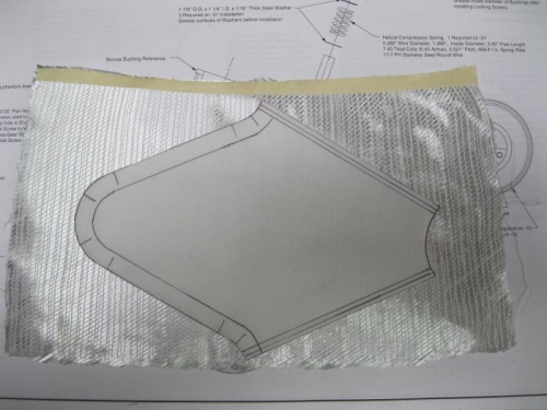

Tonight I drilled the holes in the firewall opening to install the steering linkage boot. I also made the boot from fiberglass and RTV. I still need to sew the boot together.
Fiberglass and pattern ready to apply RTV.
After RTV cures, apply pattern and start cutting.
Boot is cutout and ready to sew.
