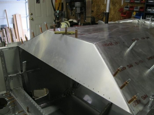

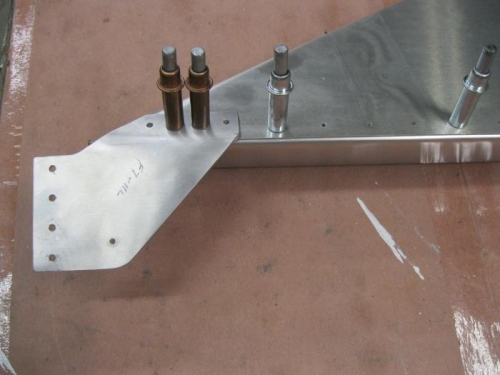

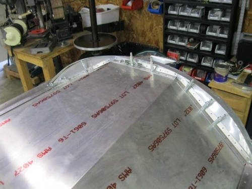

Both forward flanges on the glare-shield had to be thinned out in order to fit in between the longeron and engine mount. After getting it to fit I located and pilot drilled the glareshield and the firewall angles. I did the final fit and pilot drilled the instrument panel, panel crosstie and left and right corner plates.
Glare-shield and panel clecoed.
Glare-shield, firewall angles clecoed
Panel, corner plate, cross-tie.
