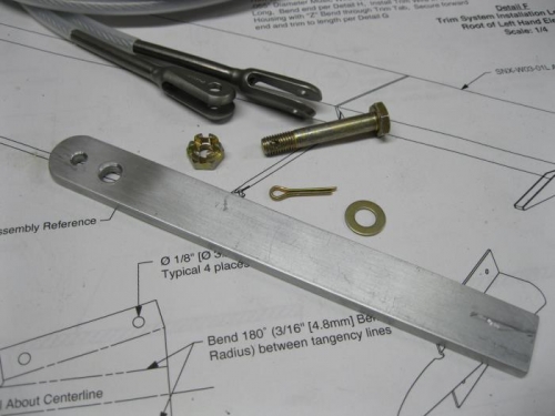

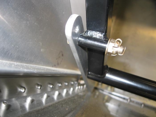

Brief Description:  Rudder cable adjuster fitting.
The mount welded onto the rudder to attach the rudderr cable adjuster is a steel tube with a 1/4 inch inside diameter. however the weld penetrated the tube and there was flashing inside trhe tube that needed to be drilled out. I was able to use my angle drill and a short bit to drill it out. I would suggest doing this prior to installing the rudder pedals.
Rudder cable adjuster.
Welded tube drilled out with adjuster installed.
Cable adjuster without cable attached.
