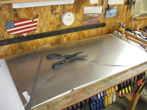

I have decided to modify the instrument panel to allow me to easily remove the panel to make changes or repairs.

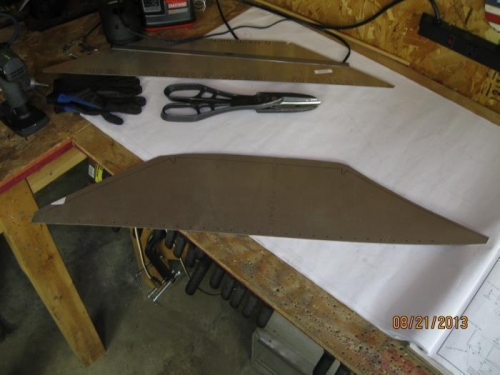

Today I fabricated angles to attach to the glarshield and then use nutplates on the angle flange to attach the panel with machine screws. The only change to the panel is to cut off the flange that would have been riveted to the glarshield. I made an extra instrument panel for future modifications.
Layout of two instrument panels.
Cutting out the panels
