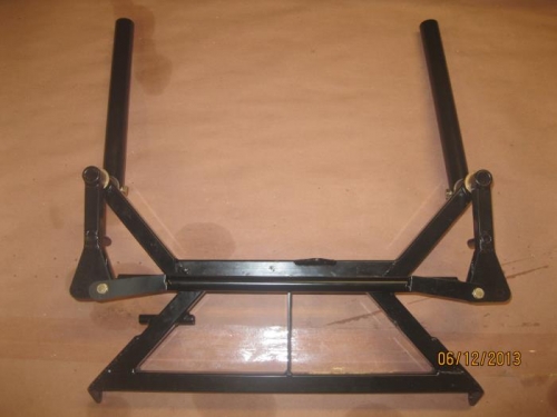

Brief Description:  Build dual control stick assembly.
Today I built the dual control stick assembly. I had previously used JB Weld to install the flanged bushing into the A frame assembly. The plans called for the bushing to be press fit but was too loose to press in. Sonex recommended JB Weld. It seems to have worked well.
