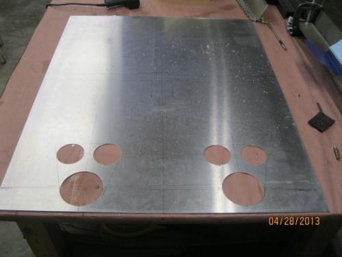

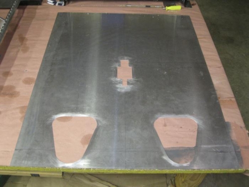

Tonight I cut the seatpan following plans C06, lowered seat modification. I used the fly cutter for the large openings. I drilled a series of 3/32 holes and then cutout the small cutout. The seatpan is now ready to bend 88 degrees toward the middle and 11 degrees at the front.
Use of flycutter on seat cutouts.
Ready to start trimming and filing to final shape.
Finished seat pan cutouts.
