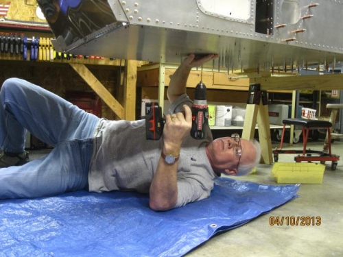

Number of Hours:  4.00
Manual Reference:  C06
Brief Description:  Pilot drill lower forward fuselage parts.
With the forward fuselage lower assemblies clamped into place, I began positioning and pilot drilling the parts. I made multible trips from under the plane to verify the correct position of the parts, and then back up to make a very small adjustment. I would then go back under to pilot drill the part and up to verify the the hole was in the proper location. Then back down again to pilot drill the rest of the holes for that part. I repeated the process for 8 parts over 2.5 hrs.
Looking at lower fuselage parts.
