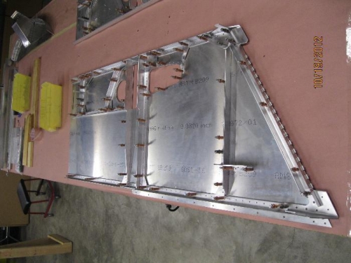

left and right fwd fuselage to take apart and deburr.
Left fwd fuselage ready to rivet.
