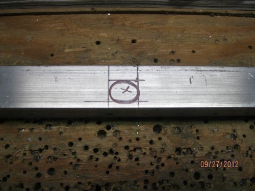

Cutout hole in right upper longeron.

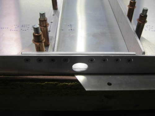

I cutout a 21/32" X 1/2" hole in the right upper longeron and then drilled, countersunk and riveted the longeron doubler.
cutout hole in upper right longeron.
Countersunk rivets with doubler on right longeron.
