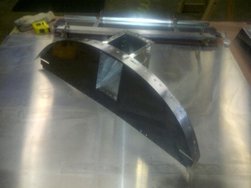

Tonight I used a small grinder stone to remove the burrs on the firewall. The 11/32 holes I drilled in the stainless steel firewall to accommodate the 1/4 turn fasteners had large burrs.
I step drilled the holes using 5 different bits with lube and I thought the process was going well, but found out after, that the holes were actually melting and pushing out on the back side. I am also hoping this assembly will fit properly because there is a slight bow. I previously read were other builders have had the same problem and I was still unable to avoid it myself.
The assembly is now complete along with several smears of my DNA. I hope this is the last of the stainless steel sheet I'll have to work with....
Upper firewall assembly.
