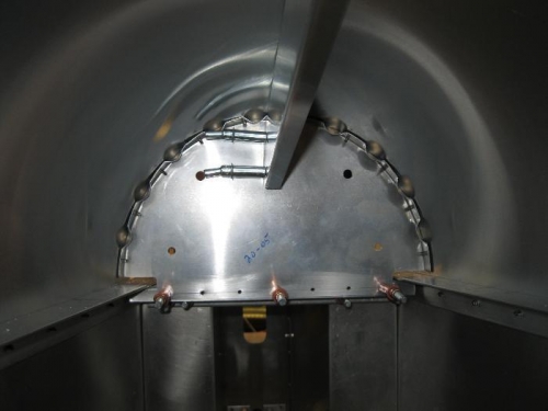

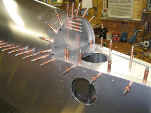

Brief Description:  Pilot drill and cleco #5 former and install rear f

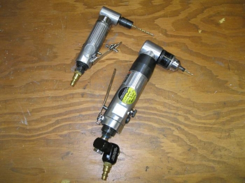

I pilot drilled and clecoed the #5 former and installed rear former clip. The rear clip was the most difficult because of the small area to drill at the tip of the tail cone. I used the air die grinder with a collet to attach the #30 & 40 drill bits. This is the first time I have used these tools but they worked great and I only paid about $15 a year ago for the die grinder and about $25 for the drill.
Tail cone and former.
Inside tail cone looking aft at former.
Air die grinder and air drill.
