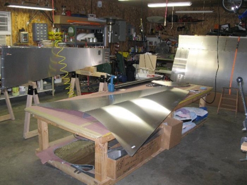

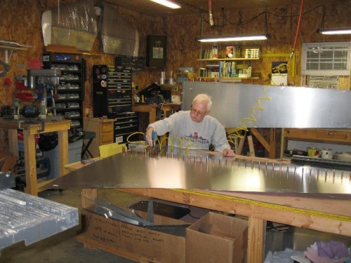

I updrilled the turtledeck, deburred and riveted the splice and turtledeck halves. The turtledeck will be fit inside the fuselage side skins 1 inch. I marked the 1 inch location along the turtledeck.
Riveting the turtledeck.

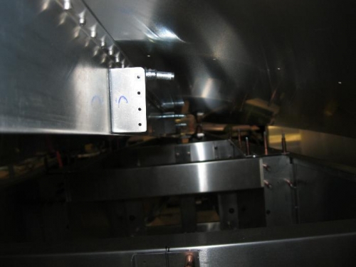

Under view of splice and clips.
