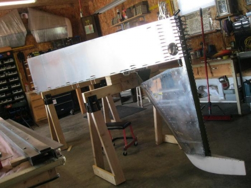

Date:  4-8-2012
Number of Hours:  3.25
Manual Reference:  F21
Brief Description:  Flip aft fuselage to work on tail cone.
My wife helped me flip the aft fuselage and remove the bottom skin so I can work on drillibg the tail cone assemblies. I have left the vertical stab in place to ensure that the leading edge remains perfectly aligned with the fuselage centerline. All the drilling went very well and I am now going to flip it back to begin the Turtledeck.
