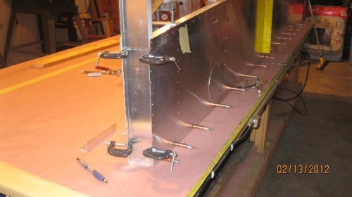

Brief Description:  Position, drill and cleco shoulder harness web bra
Tonight I positioned and I updril;led the bottom skin to the lower lomgerons and lower cross ties. My wife helped me to flip the fuselage box over onto the new wooden saw horses where I will finish the aft fuselage.
After flipping the fuselage I removed the bottom skin and checked again and found that I am out of alignment. I really don't know what happened. I was perfect when I drilled the cross ties. I will have to resolve this issue before continuing with this part of the build.
I pulled the vertical stab and rudder assembly off the wall where it has been in storage for almost 2 years. It was the first assembly I built. I need to remove the lower tail channel from the vertical stab to attache to aft fuselage tail cone assembly.
