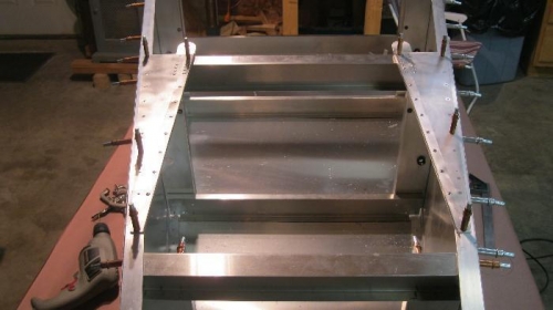

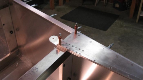

Brief Description:  Pilot drill upper and lower cross ties. Aft shear
Continued to work on the cross tie box and the cross ties. Pilot drilled the upper and lower cross ties and updrilled the upper cross ties. I positioned and clamped the aft shear web assembly and tail wheel bracket to the aft bulkhead. I also remade clips F23-12 when I found that the clips are riveted to the side skin. The holes were not perfectly aligned and because the rivets are visible on the skin I remade the part to look better.
Tail cone, shear web assembly.
Shou;lder harness web brackets.
