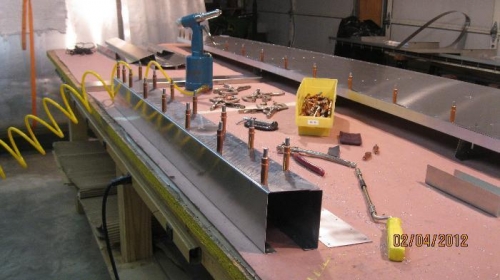

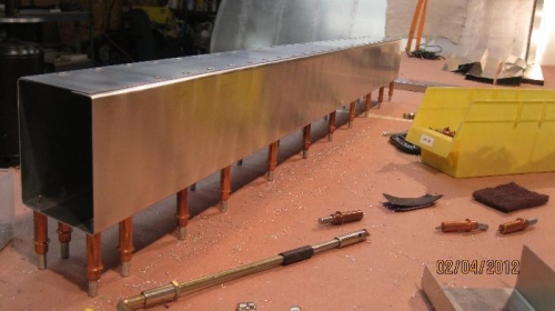

Cross tie box more difficult then expected because of a lot of close tolerances. I should have looked ahead in the plans to see how these fit together. I would not cut the channel until after it was drilled and clecoed together in order to better match the top and bottom pieces that were lazer cut and drilled.
Cross Tie Box assembly.
Cross tie box.
Cross tie box.
Finsished. Bottom rivets installed in a ater assembly.
