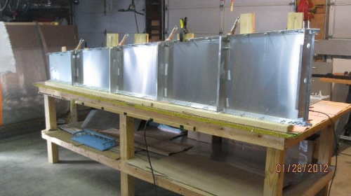

Brief Description:  Drill right aft fuselage skin vertical zees.

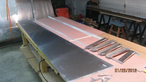

I fastened the aft fuselage skin to the newly constructed rack with clamps and 2 bungee cords. I then clamped into position the vertical zees onto the aft fuselage skin. I pilot drilled, clecoed and updrilled the vertical zees.
I removed and loaded the left aft fuselage skin assemply and repeated the process.
I then updrilled the left longerons and removed all of the clecoes to start deburring.

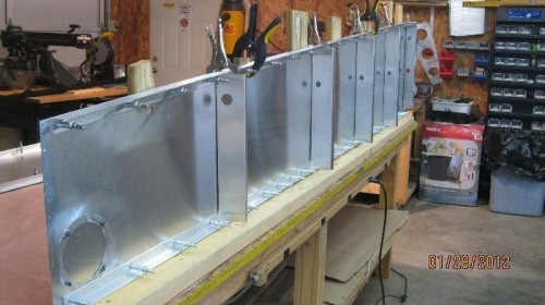

Position and drilled vertical zees.
Left aft fuselage is all updrilled and ready to start deburring.
