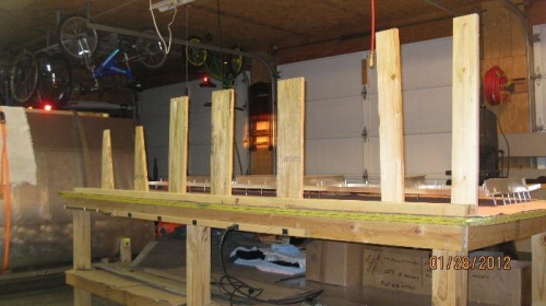

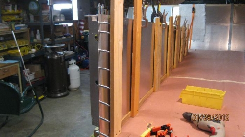

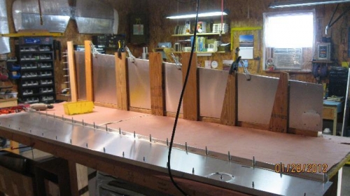

Brief Description:  Setup rack to position work on aft skins.
After some serious head scratching I came up with an idea for a rack to hold the aft skins while I measured, positioned and drilled the holes for the vertical zees. It worked out really well.
Rack to hold skins while marking and drilling the vertical zees.
