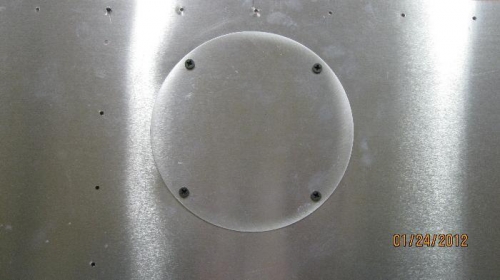

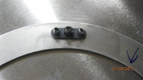

Drill holes, install nut plates for access hole.
Drill holes and dimple the lug holes of the nutplates. Flush rivet the skin and reinforcement ring on the left and right aft fuselage halves.
Inside fuselage skin.Reinforcement ring and nutplates.
Nutplate
Outside skin showing access hole cover.
