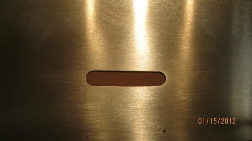

Cut the rudder cable holes in left and right aft f
Cut the rudder cable holes in left and right aft fuselage side skins.

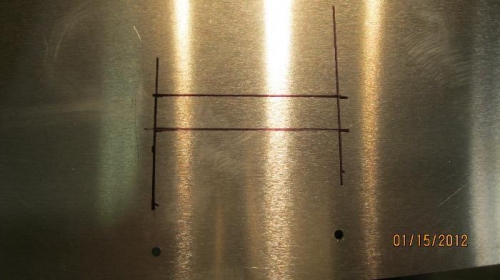

layout position of rudder cable hole.

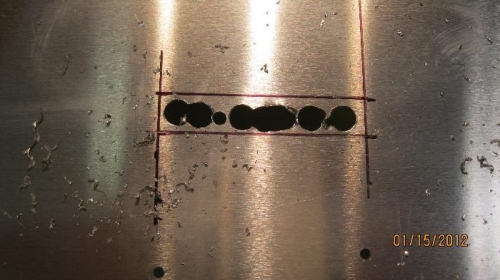

Drill a few holes.
File to finish.
