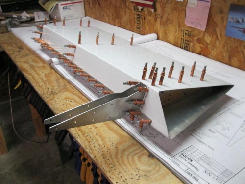

Manual Reference:  W03
Brief Description:  Updrill Right Aileron

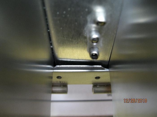

Everything went well during the pilot drilling and clecoing the Aileron skin so I started up drilling everything. In the end it looks very good except for the space between the Counterbalance spacers where the spacers, aileron skin and hinge are riveted. After thinking about this I have decided to insert a spacer between the skin and the aileron spacer.
looking at gap between skin/hinge and the aileron spacer.
