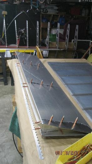

Brief Description:  Pilot drilled flap ribs and updrilled all to #30.
Tonight I fit and updrilled the the right Flap assemply. Removed clecos and deburred the outside flap skin and the ribs. I need to fit and drill the flap hinge hole locations on the flap skin. This is difficult because the hinge must be .057 inches above the bottom of the flap edge.
Right Flap Skin cut and updrilled.
