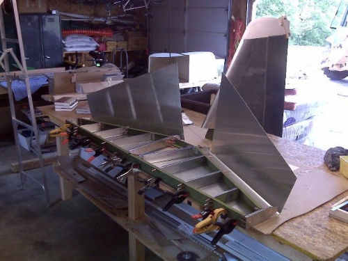

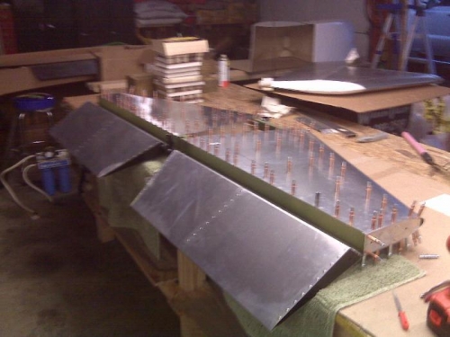

Brief Description:  Pilot drill Ribs from Pilot Holes in skin.
Drill #40 pilot holes into the rib flanges using the skin pilot holes as a guide and then clecoed the skin to the Ribs.Fit pilot drilled Elevator Hindge and attached to the Horizontal Stab to test fit.
