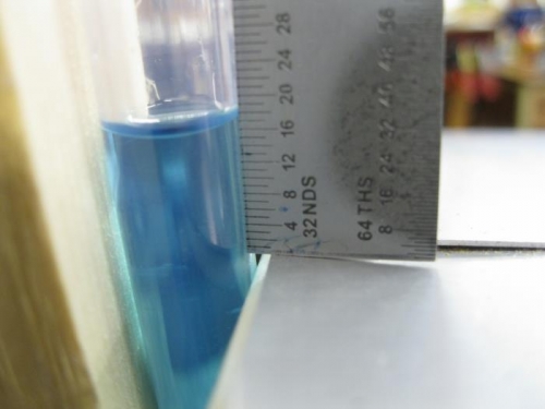

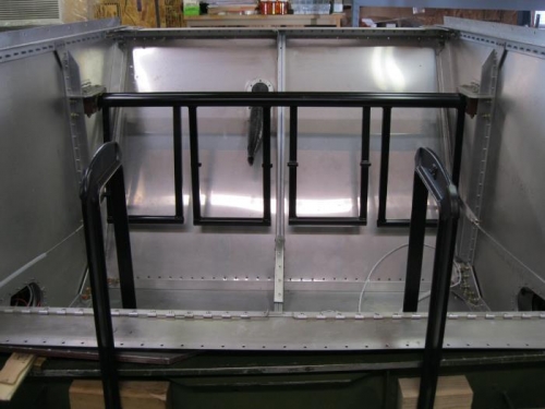

Several hours leveling wings for an other attempt at rigging wings. Fuselage leveled forward and aft. The alignment pins are in and the wings are level with the water level. I used bottle jacks about 1/3 out from the fuselage to level the wings. I also used shims between the two spars to help secure from movement. Additionally, I used two large C-clamps to hold the spars together.
View lookin forward at clamps
Clamps in place to secure spars.
Wing tip water level
