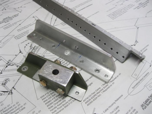

Brief Description:  Remove wings and drill out the forward fuselage an
Ok. after removing the wings I started drilling out the left forward fuselage attach angle. The process was super quick and easy. I then removed the the spar root and end attach angles and blocks. I made a new root angle, end angle and blocks. I ordered a new fuselage angle because the part would be an exact match for the original and with all of the pilot holes in the right location all I needed to do was updrill and countersink. This was also fast thanks to perfectly matched parts from Sonex.
Removed the bad drilled wing attach angles and block.
