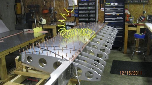

Cleco and rivet top skin and aileron hinge half.
Cleco and rivet top skin and aileron hinge half. The wing walk is installed at a later.
Top skin clecoed and ready to rivet.

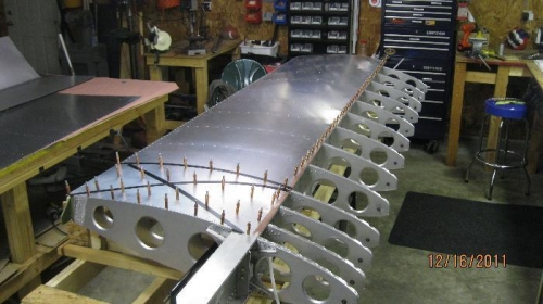

Top skin riveted except for the wing walk area. The wing walk is installed later.

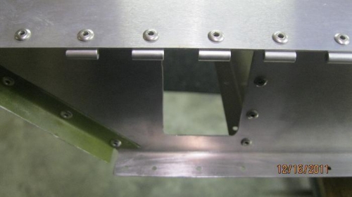

Aileron hinge halk riveted to top skin and aft spar.
