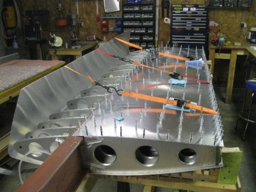

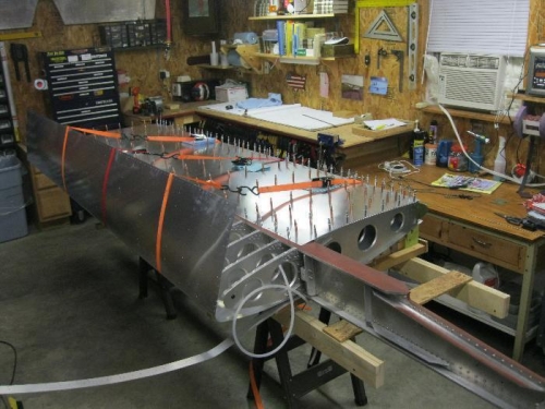

Brief Description:  Flip wing, fit bottom skin and forward skin.
