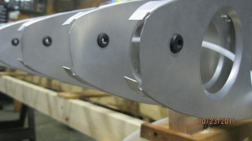

Brief Description:  Cut materiel from nose of forward rib..
Finally starting work again on the left wing. With the wing up on the build stand, I trimmed the nose of the forward ribs to prevent them from dimpling the forward skin as it is puilled into position. I did not trim the right forward ribs until after the dimples appeared when I pulled the skin into place.
Trimmed the nose of the forward ribs.
