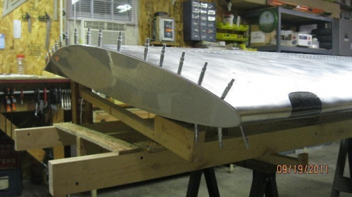

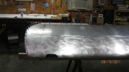

Flipped the wing again. Clecoed and then riveted the top skin along the main spar and the first 2 rows of rivets. I will wait until after the inspection to complete the final riveting.

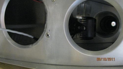

I also cut and fit the fiberglass wing tip. It fits really nice. I drilled #40 pilot holes for now and will decide if I should install nut plates for easy removal. I am leaning towards riveting with aluminum rivets which would be easy to drill out if needed. However the landing light is good for about 50,000 hours so I probably wont' need access.
The last thing I did today was to install the shielded wire into the milky white water line and install the Molex connectors.
Leading edge, landing light.
The wing tip clecoed into place.
Installed hook-up wire to the landing light
