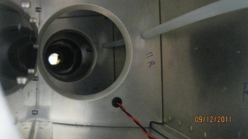

I ran the milky white water tube as a conduit for the landing light wiring. I also twisted and ran 20 ga wire for the position and strobe lights to be installed later.

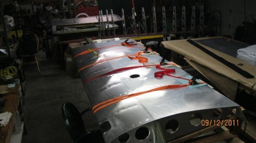

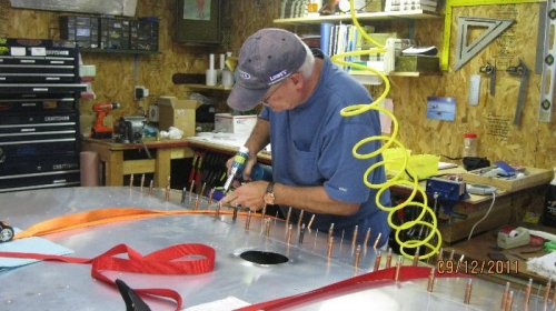

I completed the final inspection and deburring of the bottom leading edge skin and used the ratchet strapes for the last time (on this wing) to draw the leading edge into position to cleco. The riveting went very well with only 3 protruding rivet heads that were easily punched in.
Top water line for the landing light wires. The bottom wires are for the position/strobe wingtip light
Riveting the bottom of leading edge.
Leading edge finally finished and riveted.
