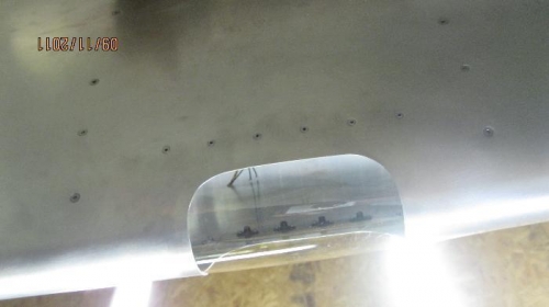

Now that I have the brackets installed I am going to attempt to cut and shape landing light lens and fit it into the mounting brackets.
I cut the lens on the bandsaw 1/2 in off the cut line which was very good because there are lots of cracks. I used the aluminum oxide wheel to clean and shape and then used 220 grit paper for the final smoothing of the edges. This worked out well and looks good.

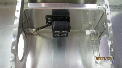

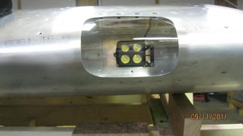

I also cut and mounted a bracket between the 2 forward ribs to attach the Sunllight landing light from Aero Led that I purchased at Oshkosh 2011.
Looking down from top skin.
Landing light installed.
